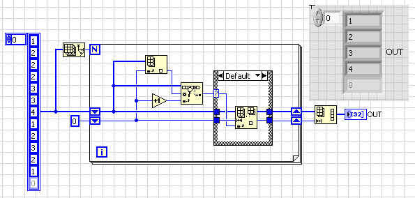

Message 4 of 38
(12,443 Views)
This one is much faster (for large arrays)
attached vi (LV2011)
Message 5 of 38
(12,431 Views)
Message 6 of 38
(12,418 Views)

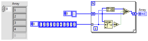

I suspect that it could be made significantly faster for large arrays, because your search and delete is basically O(N²) (guessing), while the sort method is roughly O(NlogN). Delete from array is also very inefficient to use, because for every single delete operation, all higher elements need to be moved down (Arrays need to be contiguous in memory!). The last element in your array will get moved many times, depending on the number of duplicates. Way too much work!
Try to improve it! 😄
Message 7 of 38
(12,413 Views)
@apok :
Why complicate things when they can be simple?  Smiley Happy   kudo.
@altenbach:
all higher elements need to be moved dow, the last element in your array will get moved many times, depending on the number of duplicates
thank you altenbach for your explanation
you're absolutely right, I had not looked at it from this angle. Understood!
Indeed, my code is very slow,
the code from Apok is much better and much faster.
Message 8 of 38
Mine is still orders of magnitude faster than both for large input arrays. 😄
For example for a size 50k input i get the following:
case 1: all elements are the same:
altenbach: 3ms
ouadji: 1300ms
apok: 25ms
case 2: 95% of elements are unique:
altenbach: 7ms
ouadji: 770ms
apok: 3800ms
