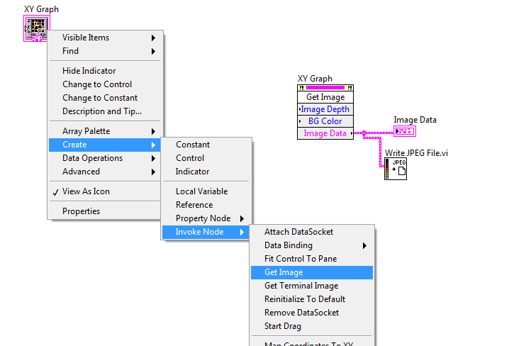

like this?

I meant something like excel or individual image file like shown above?
as individual image.

You can use a save button and put the save inside a case.I have already shown you how to save as image then.Smiley Wink

So where is destination folder defined  to save jpeg files?
