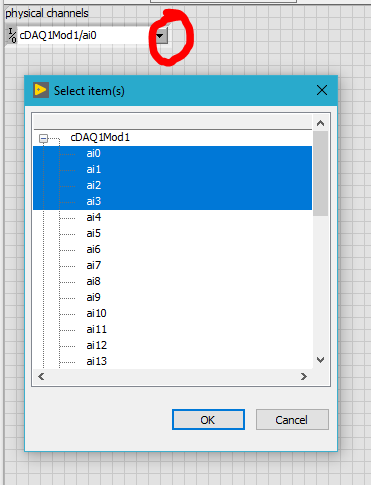

I uploaded a picture(it is a example, how it could look like. I do not have the actual code for it), which shows two physical channel selections. Basically it is about adding/superimposing signal 1-4 and putting them out to channel left or right, depending what I have checked. I only wrote the code in my start post to test how I can put out two different signals at the same time.

I know I was thinking it, but I must have forgotten to type the part where you need to hit the "Browse..." menu choice when you hit the down arrow.
I'm sure you must have seen that one.
Then you get the dialog box where you can pick multiple channels
Capture
