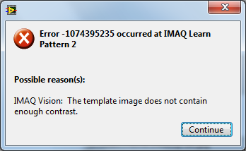

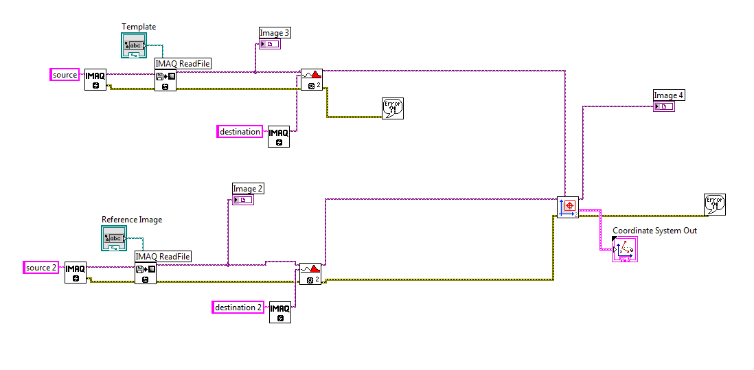

Here is what I tried to do, I used a AutoBthreshold2 and I didn't set a value to it. The image is attached below and the template. Thank you.
Here is the error.
(2,906 Views)
Hello Pinkman,
The first error you're getting is described in this knowledgebase article:
http://digital.ni.com/public.nsf/allkb/f05924d50ad6472b86256f320075cdbf?OpenDocument
The conclusion is that you need to pick a replacement color that is high enough contrast for the image. For thresholded images, I played around with it a bit, and found that teal ("5" on the input of "replacement value") works fine. Then you still get errors finding the image. This is explained in this knowledgebase article:
http://digital.ni.com/public.nsf/allkb/A3A6AE15BE2100C0862574E500553547?OpenDocument
The article is about the vision assistant, but it still works fine as long as you use the "IMAQ Equalize" VI before using Find Coordinate System.
