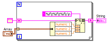

Hello schloronzo,
make a for loop feeded with your array. Inside the for loop unbundle the cluster, "format into string" the 3 values, adding the result to the ones before and collect them in a shift register. Then save the resulting string to a txt-file. If you make a good format string then Excel is able to read your txt-file (use tab a separator and CR/LF after each 3 values aka "csv format").
(4,155 Views)
Place a for loop on the diagram, with a Cluster to Array function in it. Wire your array into the loop and into the Cluster to Array function. Wire the result out of the loop and into the 2D data input of a Write to Spreadsheet File VI (File I/O palette).
Wiring the array into the loop causes auto indexing which extracts each cluster and then transforms it into a 1D array. Wiring this out of the loop builds the 1D arrays into a 2D array.

Do you have a picture or example?
(3,096 Views)
Hi Brandaoh,
you really ask in a 13 years old thread for an image?
You got luck:
