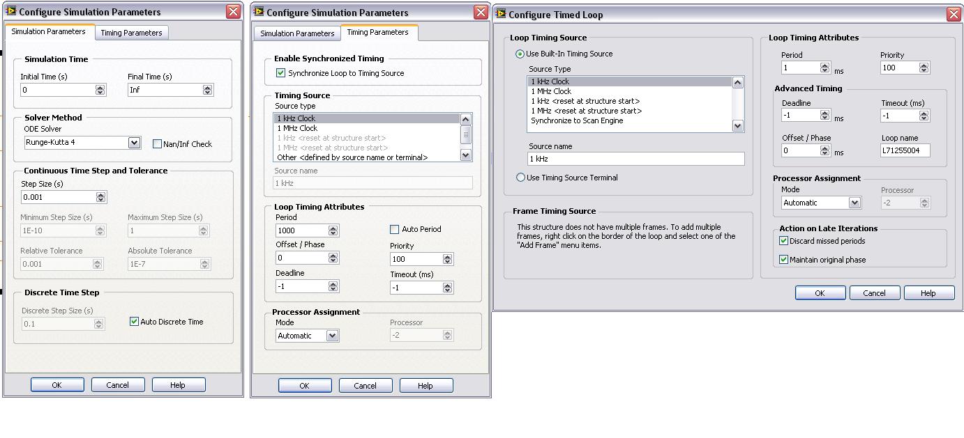

I’m new and I hope that somebody can help me. my problem is this:
i wanna use simulation loop of module control design & simulation on a FPGA CompactRIO 9014 but I don’t know how to timing of target FPGA 40 MHz with the parameters of configure simulation parameters.
When I try to compile my program I get this error…

This is my configuration
I use labview 8.6
compactRIO 9014 4MHz

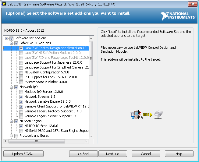

Hey zeuszero,
This isn't exactly my area of expertise, but since no one had replied to you yet I just wanted to share my initial thought.  Sometimes I run into problems with Real-Time hardware when I don't have the proper support installed, then get similar errors like you. So, can you verify that you have installed the Control Design & Sim support on the RIO controller?  You software window will look different than this one if you are using LV 8.6, but I think you'll still have a similar entry.  (Go to MAX, find your RIO in Remote Devices, and right-click "Software" to Add/Remove Software.)
Anyway, that's just my first guess. I'll post back if I can think of anything else. Hope that helps.
Cheers,
