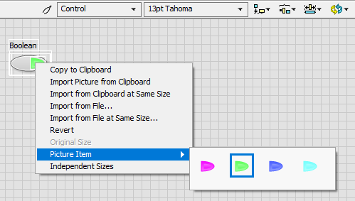

New to this forum and thank you for all of LabVIEW.
Silver style pushbuttons contain an LED that's yellow by default -- two shades, a bright and a dim yellow resembling the button's Boolean state. OK!
Now, I can use the coloring tool as pointed out here, but it is only able to change 2 of the actually 4 colors that the pushbutton has assigned to its LED.
I can set the switch False and use the coloring tool to assign the LED color for False. Similarly use operating tool to set True and assign the color for True using the coloring tool. Great! Rainbow unicorn LEDs!! Awesome!
But there is also a pushbutton state when I am using the operating tool to depress the button, and that stays yellow, because I can't get to it with the coloring tool, since letting go of the button with the operating tool ends that state before I can get to the coloring tool to change anything!
So, I have nicely color coded buttons just like a real test panel, where items are color coded for ease of recognition -- but all the buttons flash yellow when they're being depressed (before they're released). How can I assign the correct color scheme to these other 2 states?
Thanks for your help!
Message 7 of 9
(5,731 Views)
You can change all four colors in the control editor.
Message 8 of 9
(5,720 Views)
