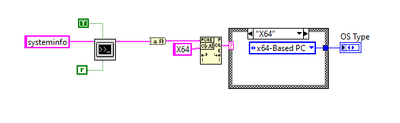

See attached VI.  depending on your admin rights you might have to add command to run as admin.  Tested on both Windows 10 and Windows 7 and works.
(4,728 Views)
shrink down to this. due to lacalization of windows that change, for example, "system type" in "Tipo sistema: x64-based PC" in Italian.
btw it works. thanks.
