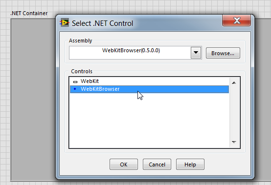

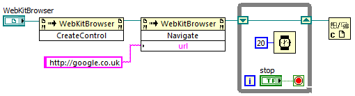

I have, however, been able to get the WebKit browser as a .NET control working fairly easily:
I tried to attach the resource pack for the WebKit browser as I can't remember where I obtained them from in the first place but I think I probably just searched for ".NET WebKit". If you have trouble finding it then I can send you the .zip with all the files in (PM me contact details). Just create a .NET control and select the WebKitBrowser.dll from the resource pack extracted to your project folder somewhere.
I haven't really played with it any more than the above example of loading a web-page though.

I did exactly that and it works for me. Create .NET container, right click and insert .NET control, browser to WebKitBrowser.dll and then it shows the WebKitBrowser control in the list underneath:
Have you checked you have all of the requirements installed? (.NET Framework 2.0 and the Visual C++ 2008 SP1 runtime)

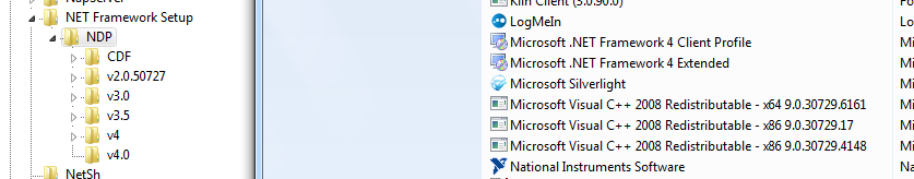

1) .NET 4.5.1 does not include .NET 2.0/3.0/3.5 etc. - you specifically need to have .NET 2.0/3.0/3.5 (3.0 and 3.5 are extensions to 2.0). .NET 4 is separate to 3.5/3.0/2.0. Do you have .NET 3.5 installed?
2) You have to be very specific about the "Microsoft Visual C++ 2008 Redistributable - x86" - there's no mention of Visual Studio in there
I have a virtual machine for doing LabVIEW at home and again, it worked out of the box without needing to do anything with unblocking assemblies. Here's a list of the versions of .NET I have installed (HKEY_LOCAL_MACHINE\SOFTWARE\Microsoft\NET Framework Setup\NDP)  and the Visual C++ redistributable:
(blog)

Sorry Sam, I meant that I had installed the Visual C++ 2008 Runtime.  See my image for confirmation.  I've also found where I can activate the .NET 3.5.1 run time in Windows 7 (see image for confirmation).
Still no luck.

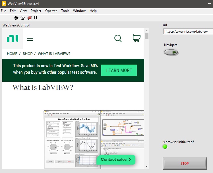

I had success hosting the Microsoft Edge WebView2 control that is also Chromium based.
Implementation is pretty straightforward. AnyCPU build works with both 32-bit and 64-bit LabVIEW.
The only downside is the control requires either Microsoft Edge or the WebView2 Runtime to be installed.
I posted my source code and examples here
