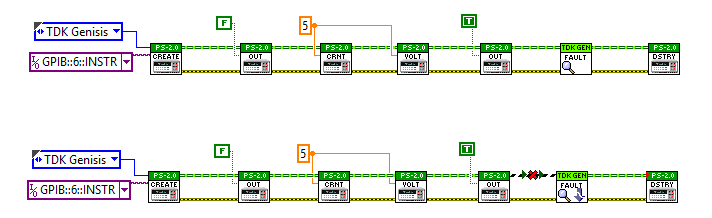

Attached is a zip file containing a basic set up of the code.  The project can be found at …/Labview Projects\Project Base\Proj.  Once loaded you can see Main.vi in the project window.  There are no controls (there will be when implemented, this is just a proof of concept project to make sure I have things built correctly), so pop on into the back panel.  From there you should see this.Main.PNG
First, I would like to discuss the top chain of vis then I’ll circle back to talk about the bottom chain.  The subvi 2nd from the left in both chains is the one in question.  It is meant to query the TDK Genisis power supply for faults.  Going into the top chain’s error query, you will see the following.working error query.PNG

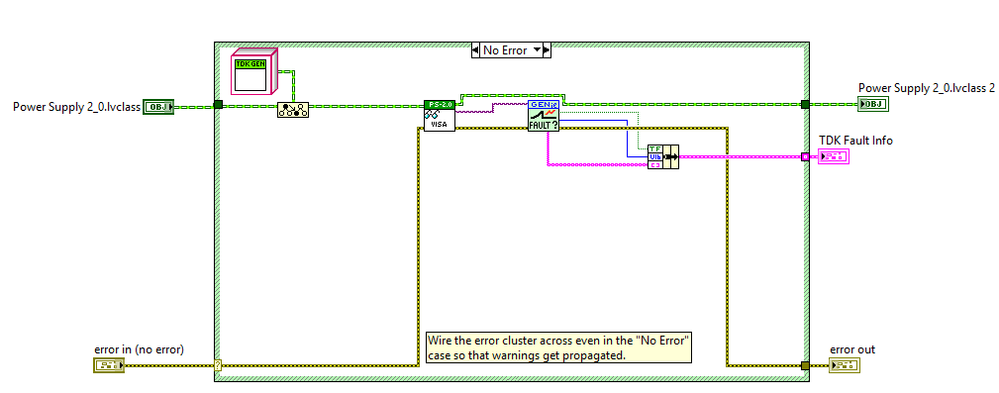

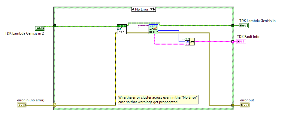

The parent class is casted into the proper child class via to more specific (not sure if this is required, the VISA is stored in the parent class).  Going into the bottom chain’s fault query, you will see the following.broken error query.PNG
The difference between these two is that I am using proper child class (TDK Genisis) in the bottom chain VS using the parent class (Power Supply 2.0) for the top.

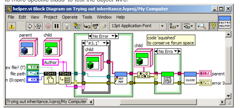

As someone who is new to OOP design in general, I’m not sure if I should be using the parent class in the child class’ private methods.  That feels wrong to me because I feel like I’m abusing the encapsulation idea.  The other idea I had was something I found by a post from QFang.  He had had his main vi do a to more specific of the child then put that in an error case statement, see image below.  I think that could work, but it feels like a lot of overhead and would be a nightmare to switch out if I brought code over to another station with a different power supply.QFang post.PNG

With the factory pattern you generally have a parent class (interface class) that is either empty or has very limited functionality. This class is the one that exists in your project.  Then, at runtime child classes are dynamically loaded into memory as needed. What this means is that ANY functionality you want to have in the child class must have at least a shell dynamic dispatch vi in your parent (interface) class.  Without that it breaks the factory pattern because, as you pointed out, otherwise you need to call the child class directly.
My solution to this is generally to shell out all sub vis in the interface class, and then at that level generate an error.  If the child you've loaded doesn't contain the functionality it returns an error.
