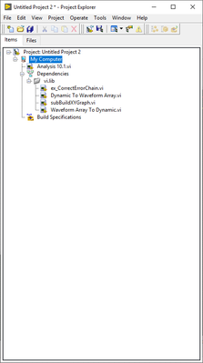

This is what I see. Not hundreds of dependencies - just the few vi.lib dependencies that I would expect.
Maybe you should zip and upload your entire project folder so that we can see what's going on.

Phew, yes I see what's happened. Version 9 was hanging around in the background somewhere and when I created the project it added V9 and V10. V9 was the one that must've had some references to the class in it.
Sorry about the waste of time. I should be able to add modules in until I find the rogue one. Thanks for the help all.
