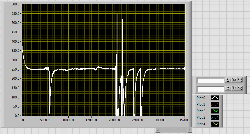

How do I make sure that my graph has multiple plots?
I am trying to get a graph of that plots from a txt file that I have. The first coumn is time and the rest of the columns are data from different sensors. From the graph that I got it looks like its only reading the first cloumn.
How can I make sure that I get a plot from every column?

Try something like the attached. (I think your array manipulations could be further simplified)

Accepted by topic author sofiakyle
Yes, read the file transposed and use "delete from array" as follows:
Much simpler! 😄

Thanks! I tend to make things difficult...
