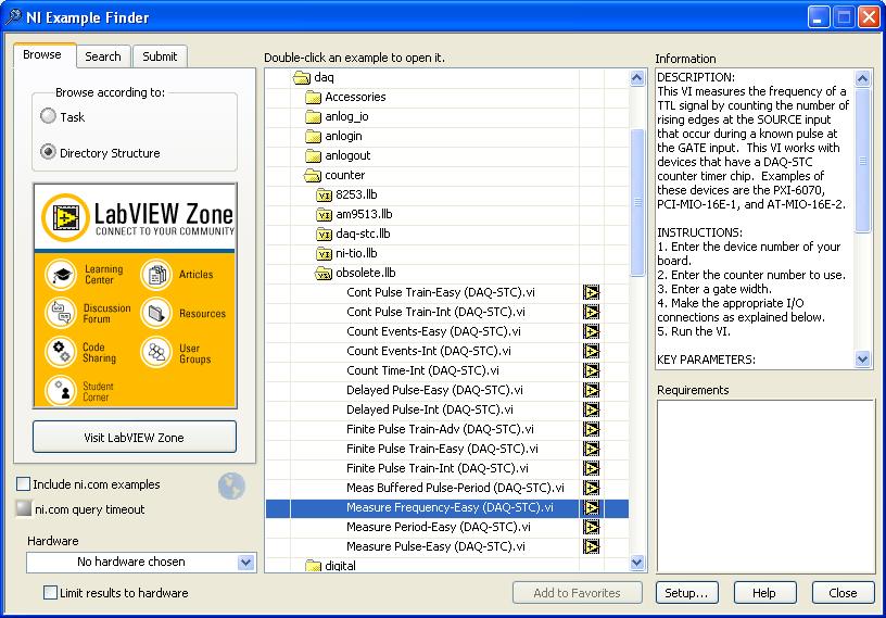

I would suggest looking at page 3-22 of the AT-MIO-16 User Manual for information on how to make a frequency measurement with the AT-MIO-16E-1.  There is also information on page 2-13 of the BNC-2090 User Manual on how to access the counters on your MIO board through the BNC-2090.  As far as the VI's you should use go I would suggest looking in the example finder.  To access the example finder open LabVIEW and then go to Help>> Find Examples...  Once the example finder window comes up you should be able to find Traditional DAQ examples for the AT-MIO-16E-1 board by clicking on "Directory Structure" and then navigation to the folder shown in the image below.
