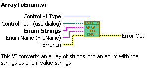

My Variant To Control code on LAVA has a demo VI to convert an array of strings to an enum.
