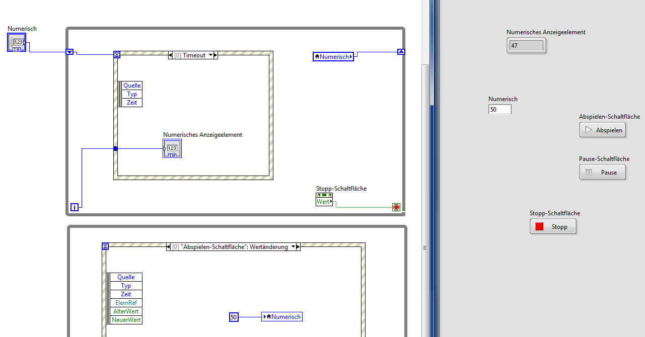

That doesn't work.
When I set the value to -1, the event runs into a dead lock, because the shift register cannot be updated without a running loop, but in order to run the loop, the shift register has to change the value.
I have two buttons to start/stop the timeout.
Two numeric outputs to display the current timeout time and the loop iterations (to check if the timeout is running).
Why is this so complicated?
Why is it not possible to register for the timeout dynamically like other events?
Why is the timeout listed in the drop down list but greyed out?
Message 4 of 18
(6,409 Views)

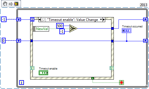

You are probably creating your own deadlock here...
Here is a small piece of code that works just fine for setting dynamically the timeout like crossrulz mentioned.

Eric, thanks for trying to help me.
Please take a look at the image in my previous post.
The timeout event structure is in its own loop.
I'm not interested in a solution that has both timeout and other events within the same loop.
They should run in parallel.

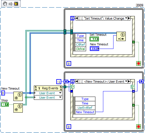

Use a User Event to send the new timeout time (either -1 to "unregister" or some other value to "register") from the first loop to the second loop, as shown below. I still have no idea why you would want to do this, but it will work fine.
