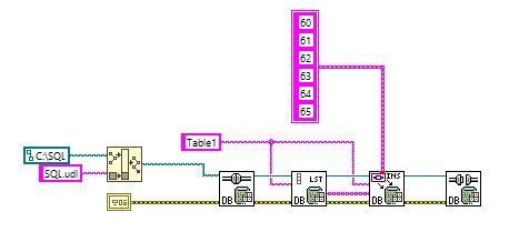

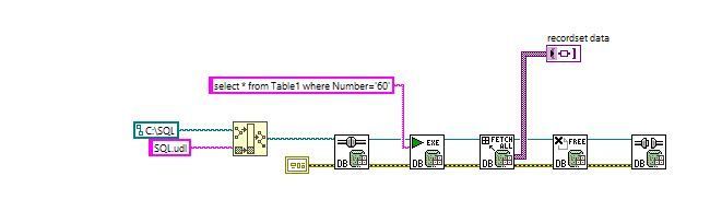

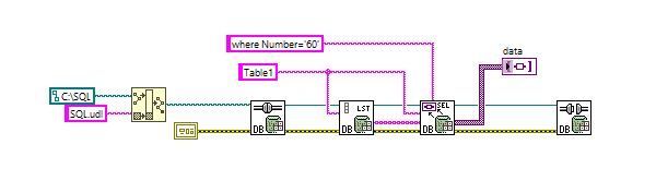

I have an application where I am trying to save a document (.pdf, .docx, .xlsx etc) into SQL, but it is proving difficult. I have used this National Instruments resource (http://www.ni.com/pdf/manuals/371525a.pdf), the Database Connectivity Toolkit User Manual to design a basic application which allows me to use certain data types (chapter 4) to input data into SQL server, I can also read my written data.
But is there a way I can insert documents into the server and retrieve/read the document later on as well? If anyone has done this before, it would be great if you can share how you did it please.
I have attached a picture of my basic code on how I write and read data. I used the Database Connectivity Toolkit.
