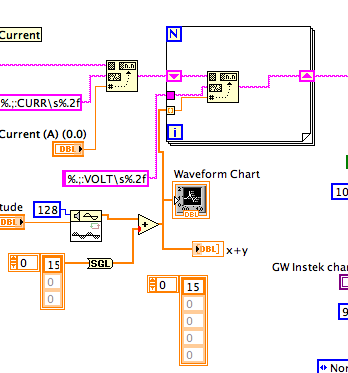

When you add the 15v it needs to be a single scaler numeric constant rather than an array. The array you added only contains one element so your output is also just the one number.
If you put a graph indicator on your numeric data you will see what signal you are sending. Adding extra indicators to your code at the development stage can be a big help in solving codeing problems, you should also check out using the Probes.

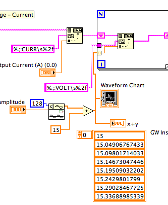

I should have said a simple scalar, rather than 'single'. Here's what it should look like:

You have not followed the suggestions which have been made. You can add a scalar to an array. The result is that the scalar is added to every element of the array. What you did was to add a one-element array (with value 15) to the sine array. The result is a one element array. When two arrays of different lengths the result is the length of the shorter input array.
This is what you have: (Note that the constant below the x+y indicator is a constant with teh same values as the indicator.)
Here is the way to add a scalar to an array.

Thanks Lynn, my problem now is whenever I try to wire a constant to the y portion of the add function, it automatically makes it a 1D array, and I'm not sure how to add a scalar.  I'm looking through the LabVIEW book now to figure it out, but not finding much...

Pull a constant from the numeric palette first, then connect it to the + function.
