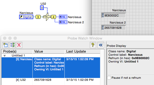

I would like to get the numeric value of a reference.  If I watch any reference with a probe, I can see it's value, i.e. F280006B.  I would like to get that numeric value into a numeric indicator for some troubleshooting I am doing. but running a ref directly into a numeric indicator breaks the code. Somehow the probe is doing the job, so it must be accessible. Any hints out there?

Type cast to U32.

This is perfect. Thank you very much.
