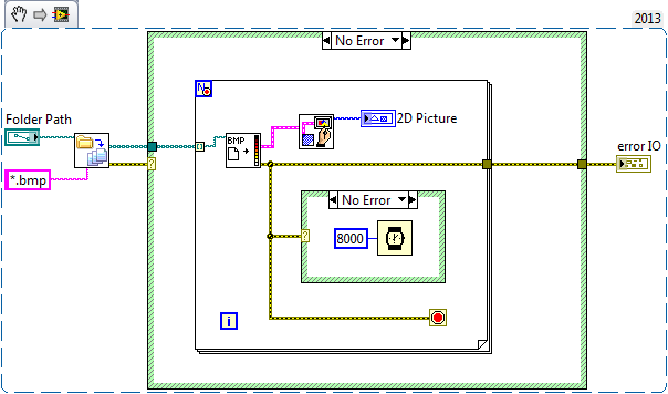

Hi!
If the images are labeled in a way that they will be sorted correctly by name, the task is trivial.
Have a look at the snippet below.
Best regards
Dan

Thank you so much for replying. I basically cannot read the diagram as I mentioned that I am very new to all this. Could you please provide me the VI if possible. I highly appreciate your help,

What was posted was a Snippet.  It is a VI just saved as a picture.  Drag the image from your browser to a folder on your computer.  Then Open LabVIEW 2013 (the version the snippet was saved in) and drag the file from your computer to your block diagram, it will then have the code in it that is shown in the picture.

Thank you so much Sir. But the version which I am using is Labview 2012. It is unable to accept that.

Awesome SIr. This is working. Thank you so much Sir. I highly appreciate your support.

Hello again!
Ok, so i saved the vi in LabVIEW2012 for you.
But really, you should take the introduction course to LabVIEW or something. You wont get far if you cant even reproduce that pretty simple vi.
