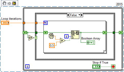

Note that your example code doesn't do this -- your random number test resets array elements to true or false depending on the test.  But never mind, you can, in fact, "have your cake and eat it, too".
The idea is to use an uninitialize Shift Register, and initialize it (once) inside the While Loop.  Here's a picture (this is a Snippet -- if you drag this into a blank LabVIEW 2015 Block Diagram, through NI Magic, it will become LabVIEW Code).
This is more-or-less your original code, except there's a Case Statement in there, and nothing is wired into the Shift Register from the outside.  This means that it "takes on its default value".  Well, because you wired it inside the loop to be an array of Booleans, it take on the default values of Array (empty array) of Booleans (false).  That means that when the program starts, it sees ... an empty Array.  We can test that (that's the Compare function, "Empty Array?") and if it is true, we can execute the code you can't see inside the True case, which here just creates (using Initialize Array) an Array of 4 "False" Boolean values.  Then it exits the Case, hits the Loop, goes back and reenters via the Shift Register as an Array of four False booleans, and away we go!
When you stop it and start it again, the Shift Register "remembers" its last value, so it won't re-initialize, as it isn't empty.
Enjoy.
Bob Schor

As I understood the problem, he specifically did not want to "reinitialize every time you restart the main VI".  I tried First Call?, realized that a restart would result in a "True", so came up with this method.  You are right, however, about resizing the array -- this can also be handled by a similar maneuver (I presume changing the Array Size would mean it's OK to wipe out the previous History).  If you put "Current Size" in an uninitialize Shift Register, then simply comparing "Is incoming size = saved size?" would take you to the "Initialize the Array" step when the size changed, including the first time you run (since the default size is 0).
