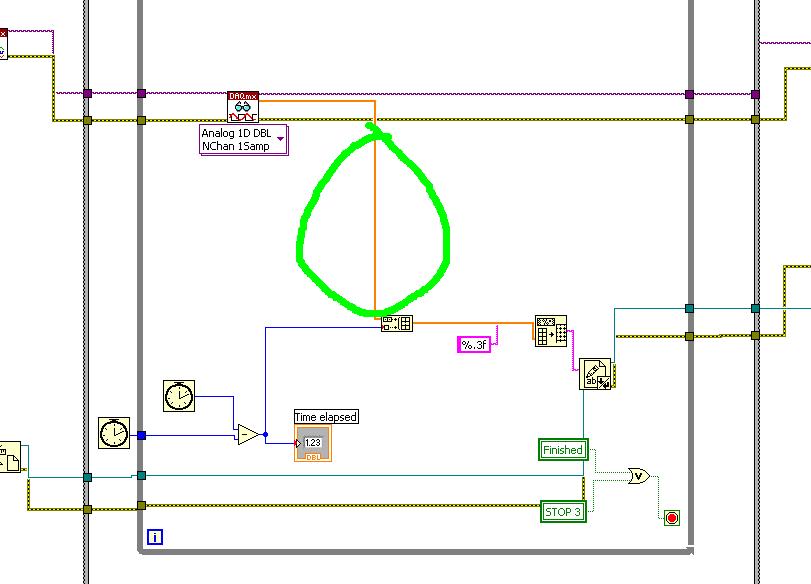

Here is an update. I figured out how to write them to the file in columns as desired. Now, I would like to add a real-time plot of each voltage input. I know the columns of data are in the orange wire (circled), I just dont know how to extract both of the plots from them.
Thanks!

So why did you change from nsamp with a precise sample rate to 1samp with a variable sample rate? Why did you get rid of the waveform data type?
Message 24 of 42
(1,505 Views)
I couldnt figure out compatibility issues with the waveform data type wires, so I tried a couple of the other settings and the 1D DBL Nchan 1Samp seemed to output what I was looking for in terms of the dataset. Is this a big no-no?
Message 25 of 42
(1,499 Views)
I have no idea what you tried. The output of the DAQmx Read would be wired directly to the export waveforms function. Nothing else would have been required.
When you switch to 1samp, you turn off the hardware timing. The time between samples is software timed and subject to a great deal of jitter because of Windows. It's up to you if it's enough.
