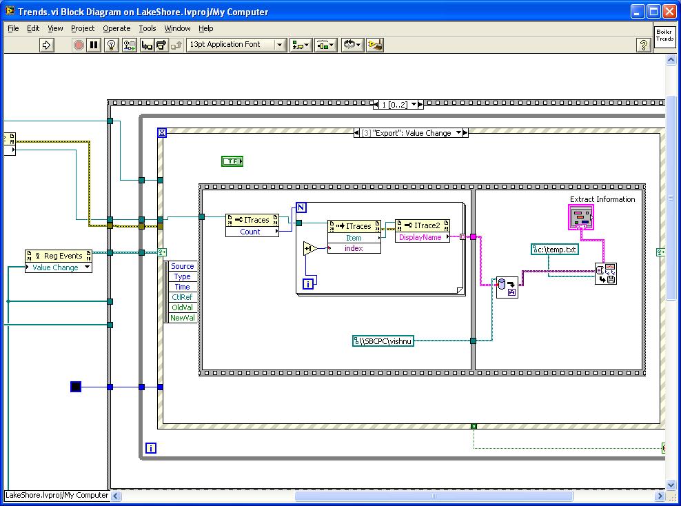

    For Extraction of data from Citadel, i am using Get Trace List from DSC module in LV8.6. I am facing problem and getting error while running this function. It gives an errror for  "database URL" input. According to HELP of LV. I have to give computer name in my case SBCPC and data base name "vishnu". So i am giving //SBCPC/vishnu. When the function run it is giving error that input should be in form of  //SBCPC/vishnu/T1  where T1 is my network variable which is i am logging.
Can any buddy give me Idea to how to use "Get Trace List"

Here with Browse Database.vi I have same error. Here screen shot of that. The same value //SBCPC/vishnu i am getting when i am probing to Browse Database.vi output.
What could be the reason for this error.
