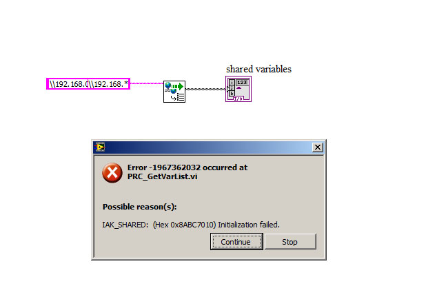

How is work "Get Shared Variable List with another computer " ?
Hi all
I can't receive the list of Shared Variables from   another computer  .
From localhost computer I received it.
Why?
Regards
Iskander

Hi Iskander,
I found a KnowledgeBase on the error you're receiving here:
http://digital.ni.com/public.nsf/allkb/96C5B8A73F624996862576CF00611A41?OpenDocument
Let me know if its solution helps.
John M.
(3,492 Views)
Hi John M.
Thank very match
I use the Search Variable Container Function
Best respect
Iskander
