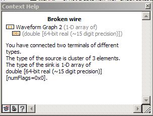

Yes, I already read the context but my problem is I have a 2D array to plot when I tryed it with "build waveform" the Y is only 1 dimension so it don't work, i will show the screen shot of context help:

and when i try to use a bundle I put time stamp, dt and the data "2d array" and linked the output to a waveform graph so appears:
Maybe is because to make a cluster I have to use relative time, but I want use absolute time so I have to find how can I change the dimension of "Y"

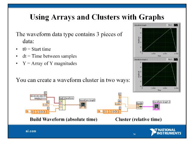

This is my problem, I already read that Introduction to LabVIEW 8.6 in 6 hours but in page 74 only show it:
I know this is very easy to solve, but I tryed several times and can't make it happens
so I'm here to get some help if you can!

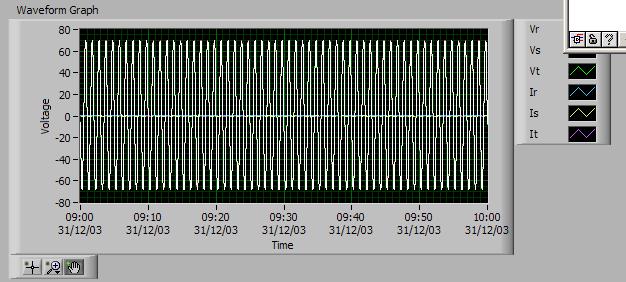

because I need to plot at X-axis the real time like "13:38pm 10/14/2009" something like that
and when I tryed put time stamp in t0 don't work!

something like that:
Now can you see? the only problem for me is the time in X-axis
"09:00 31/12/1903" i need to fix that time to the real time today
