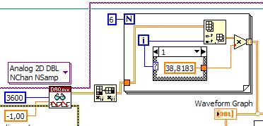

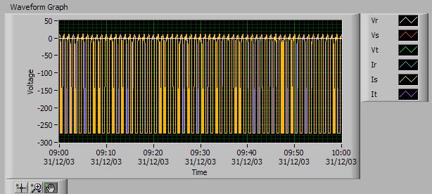

I tryed it:
But the graph was like that:
So I think, I'm commiting a mistake in somewhere!

Click on the polymorphic selector (the part that says analog 2D DBL etc) and change it to 1D waveform

Well Dennis I already use a DAQMX read 1D waveform to measure 2 temperatures
I will post the hole VI so you can take a look what i'm doing
and maybe give me some help or give me some tips to get better!

Do NOT use two separate DAQmx Reads for the same task. Use one! Configure the single DAQmx Read to return waveform datatype just like you already did and use the Index Array function or Array Subset function to get the channels you want. You can apply the scaling factors directly to a 1D waveform array. I've modified your example but since you did not post the subVI, I have no idea what it is doing.

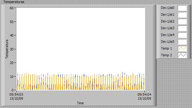

I was looking your example Dennis and I have one doubt here:
I put the graph to considerate time stamp
so now I have the real time from acquisition
but I want X-axis have 1sec
and it's 1,2sec at the moment
how can I change it to only 1sec?
As you can see at X-axis I have a 1.2second and I need only 1 sec
like 09:12:10 and 09:12:11
You can see I have some space in graph that dont have any waveform
How can I fix it?
Message 18 of 32
(3,632 Views)
Right click and select X Scale>Formatting. Change number of digits to 0.
Right click and select X Scale. Unselect 'Loose Fit'.
Message 19 of 32
(3,628 Views)
Ok thanks now it's fine!
more one doubt:
In the temperature graph I only want to show 2 plots
because the 0-5 is voltages and currents
how can I hide it? and only show AI6 and AI7?
I tryed but the color of the plot white too
but when i started the white colors stay in front of the others!
Have some way to put the colors of these plot like transparent? or something like that?
and I need to create a 2D array to connect to my subVI RMS 4V4I
how can I make one, with a 1D waveform??
Thanks Dennis!
