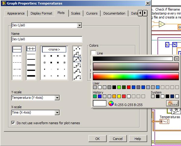

Have some way to put the colors of these plot like transparent? or something like that?
To hide a plot, pick transparent, not white.
The transparent color is the [T] in the upper right corner of the color palette.
Message 21 of 32
(3,209 Views)
Yes alten I know that
but look:
Appears a X and not a T, and when I click at X only close and don't change anything =/
Message 22 of 32
(3,207 Views)
Yes, some older version have a bug here, but that's not a problem.
Don't do it from the graph properties dialog, but simply click on the corresponding plot legend and select the transparent color.
Message Edited by altenbach on 10-15-2009 06:46 AM
Message 23 of 32
(3,204 Views)
Ok thanks it works!
but how can I put on the plot legend only the plots I want?
because I want only 2 plots Temp 1 and Temp 2
and it's appearing a dev1/ai5 before and I can't delete it!

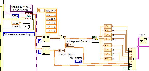

Well guys I have made some modifications in my subVI so now it's working with 1d waveform
I will upload the vi and the subVI's I'm using so you can take a look better
and I still need some help on how can I put only the plots I want in the plot legend
because I only need show 2
and it's appearing a third one I already put the color as transparent
but i want delete it from the front panel!
my code is like that now:
Thanks for all the help!
Message 25 of 32
(3,192 Views)
Message 26 of 32
(3,173 Views)
The reason you are getting an incorrect number of plots in the graphs is because I made a couple of typos. The array subset for the temperature graph should have an index of 6 and not 5. The length for the voltage array subset should be 6 and not 5.
