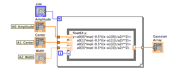

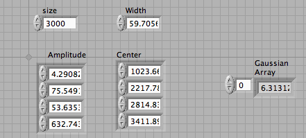

In any event, it has to run the subroutine to make the predicted spectrum numerous times.  Typically I am predicting the locations of 4 peaks in the spectrum, and the spectrum is commonly 3000 points long.  So my routine to make a predicted spectrum has the following inputs:
Where size is the # of points, width is the 1/2 width of all of the peaks, amplitude is the height of an individual peak, and center is the location of the peak in the 3000 point spectrum.  Gaussian array is the output.
The code looks like this:
 (vi attached below)
My question is:  Can I can do something to improve the speed of this calculation (in other words, am I doing something dumb?)?  Or is this pretty much as efficient a subroutine as is possible?

I would suggest that you code the calculation using native LabVIEW functions rather than using the formula node.
I've tried to refactor the VI using primitives; see attached (LabVIEW 8.6)

I agree with Phillip's suggestion to go with G.  I would also disable debugging from the VI properties to squeeze the last bit of speed out of there.
since you are autoindexing on the inner loop, the "# of peaks" input is probably not needed.

So I had a routine a little like this early on, and tried to rewrite it the way I did to avoid have as many loops, fearing they might be the source of the speed hit.  I suppose I should try running both, and seeing if I can determine which is faster.
RipRock
