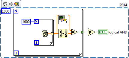

Hi Cris,
It works for me 1000 times out of 1000! You will have to add the input array and output array to the top left and right terminals respectively to run this snippet.
Message 14 of 22
(5,182 Views)
What is "it" that works?
Message 15 of 22
(5,176 Views)
I'm referring to zad1d.vi in message 12. It appears to give the same output as the native 1D sort function.

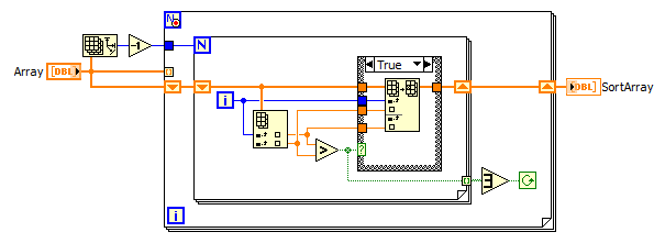

Here is version that fixes the race conditions, and also uses the inplace element structure and swap functions to simplify the array manipulation code.
