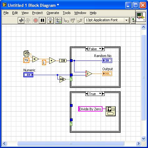

How to Build a VI that generates a random number between 1 and 80 ....Help!!!!
Divides the random number by a number specified in the front panel.
If the inputted number is zero, the VI program should turn on a LED in the front-panel to indicate a divide by zero error.

multiply the random number by 80 followed by ROUND TO NEAREST vi

You only need the random number to multiply 80. The random number produces a point number between 0 and 1.
