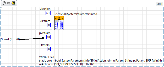

I wish to increase the speed of mouse pointer through LabVIEW. Similar to changing mouse pointer speed in Windows "Mouse Properties".
Thanks in Advance.

Try this:

Hi .aCe.,
Thanks for the solution, could you please convert the snippet vi for lower version, i am using LabVIEW 2010. I am getting error while trying to drag and drop the image in block diagram.

Here

Hi .aCe.,
Works like a Charm!!!
