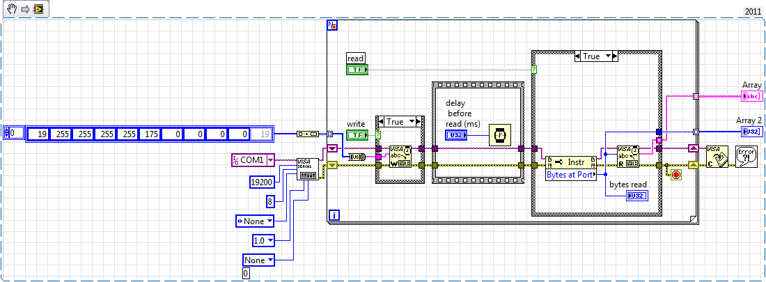

how to operate a set of commmands one by one using seqwence loop
when I'am communicating with a motor, I used the attached VI but it will work only when bulb is on. So how can I execute the same as bulb is on off state. please reply

If your delay, read & write states remain the same, you could do this.

the first blue row, how can I creat it. can you please tell me. And my motor will take a command , the next command will happen only after the first command reply comes. Is this VI will work for me. If you send me a VI it will be very helpful to me.

Thats an array constant.
You can save the file on to your computer as (.png) and drag and drop it on to your block diagram.

but I put array constant to my program, but its not coming as you fed. So can you help me in creating that row I expect your reply

I put your png file as you told but the VI shows errors as like as I attached . So please help me to overcome this

If you try to run the vi, the error listing window will pop-up. Double click on the first item in the list and it will take you to the error area. There you can find that YOU have added an array constant. Please remove that and it should work just fine.

But how can I convert each number to its corresponding ascii command. can you please help me.

in the given link it's not telling that using array constant each value will take one by one. And I need every value to be converted to ascii value which ishown in my Vi. So if you help and correct my confucsion its helpful
