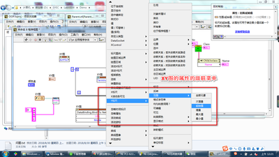

Excuse me, how to realize cascading calls of class attributes and methods? A list of properties and methods similar to controls? The cascade menu of the system's own attribute nodes is shown in the following figure:XY图的属性的级联菜单XY图的属性的级联菜单

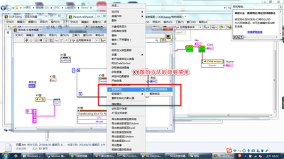

XY图的方法的级联菜单XY图的方法的级联菜单
When accessing the attributes of a custom class, there is no cascade menu. How to achieve this?
Thank you very much!自定义类属性访问,为何没有级联菜单?自定义类属性访问,为何没有级联菜单?
