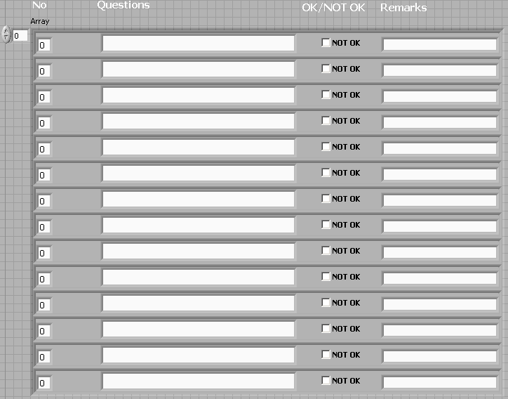

I have attached a VI in which the number of string boxes in "No:, Questions , Ok/not Ok, Remarks " are eight.
Can any one help me by changing the number of String/ Numeric boxes from 8 to 50 in all the items?

Well - I don't modify your vi, I just tell you how you could easily do it. Select two rows of the four elements, press the ctrl key, keep it pressed and drag the mouse. You will have two additional rows. I now should be ten rows. Mark all of them and repeat this procedure until you have fifty rows on your vi.

I tried the way you said but there is no connections in the block diagram and the new string boxes lay scattered all over the block diagram.
I asked to do becoz i am not sure how to connect the string boxes in the block diagram since i am new to labview.

While you could follow the copy and past approach that becktho suggested, this would create tons of wires on the block diagram. The VI is poorly written as it is - having item numbers, 50 strings for questions, 50 booleans, and another 50 strings for remarks would make it a contender for worst diagram ever. Given that you're new to LabVIEW this is not something you want to tackle as your first task. You're going to need to learn how to do LabVIEW programming, and given that you don't know how to wire up controls, you've definitely got a lot of learning to do, and suggestions that are given to you in this thread will, frankly, be of little use to you. If you need this done right away your best be is to find someone capable in LabVIEW programming to basically rewrite the VI to use arrays. Otherwise, pop open the LabVIEW tutorial, read a few books, and learn some LabVIEW programming before you try to tackle this task.

I think you will find it much easier if you had an array of clusters.   The array can be sized however big you need it.  On the block diagram, use a for loop to index through the array a perform whatever actions you want on it.  You may also look at event structures to control the read and write.
Look through the help files.  They are very complete and the examples offer some good ideas.

Can any one help me with a sample code as 'jasonhill' describes?

Sunitha,
As i say, 'Life does not get easier that LabVIEW'
building that array of clusters Jasonhill has shown is simple, Go ahead give it a shot!
