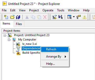

How to Refresh Dependencies in the project window programmatically?
In a newly created project window (created at runtime, filled with top level VIs), the Dependencies folder is empty.
How to Refresh the folder programmatically?  i.e. mimic select Refresh on the right click menu.

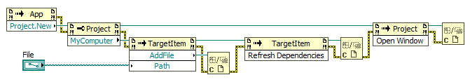

Hi zou,
Class TargetItem has a method "Refresh Dependencies":
Raphaël.

@raphschru wrote:
Hi zou,
Raphaël.
Thanks everyone.  Somehow I missed My Computer level.

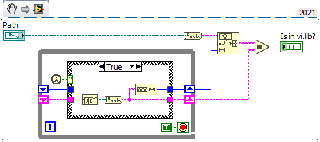

If speed is really a concern for path comparison:
Message 9 of 10
(701 Views)
