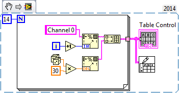

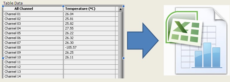

Hi Does anyone know how to save data on labview table , I want to save those data to excel file.

U can use,
1. Write To Spreadsheet File.vi
2. Report Generation Tool kit

Perhaps the OP is not satisfied with a ASCII text file being opened in Excel, and actually wants a XLS or XLSX file.  If that is the case checkout the Report Generation Toolkit which now comes with some versions of LabVIEW 2014, or look at XLR8.

We should also mention that the Write Measurement File Express VI can save data with an xlsx format.  Yes, it is the true format that Excel uses.  So if you already have all of the data, that might be a really good way to go.
