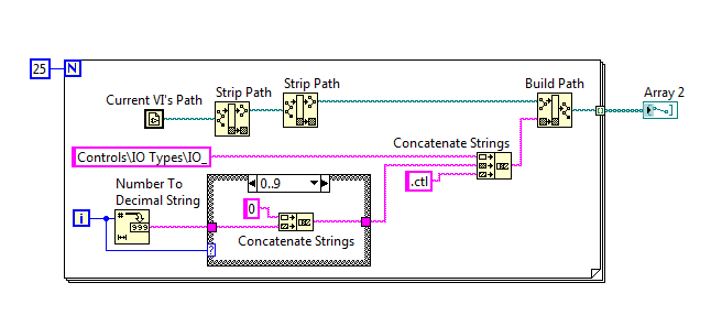

I am looking for a way, to access my custom control's data type programmatically.
I have 25 different controls(.ctl) in my project and i would like to use their different data types in different cases.
I seem to be too lazy to write the 25 cases one by one, so i built an array containing the controls' paths. The controls are ranked 0..24 and each case should use the data type determined by the value wired to the case selector (0..24).
I guess I need to obtain a reference to the controls (using the paths) but I cannot find any property node, that returns the data type (or value) of a control. Maybe I'm casting the reference to the wrong class.
Below is a picture of my array of control paths.
Thank you in advance
Adam Boros
