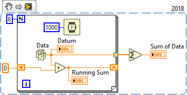

To help you out, this is an illustration (in "pictures") of the methods I was describing.  This is a LabVIEW Snippet, but even if you don't know how to use Snippets, it is simple enough that you should be able to copy it as LabVIEW code.
SumsSums
This is a For Loop (the Wait is so you can watch it run and actually see things happening) where (random) Data are being created and display (once a second) in the indicator Datum.  When the For Loop ends, all the Data (which have been brought out through an Indexing Tunnel) and summed and displayed as "Sum of Data".  The other method is shown below, starting with a Shift Register (initialized with 0) and used to compute a Running Sum.  When the Loop exits, Running Sum should equal Sum (since they both add up the same 8 numbers).
I hope this helps you out, and answers the question you were trying to ask.
Bob Schor
