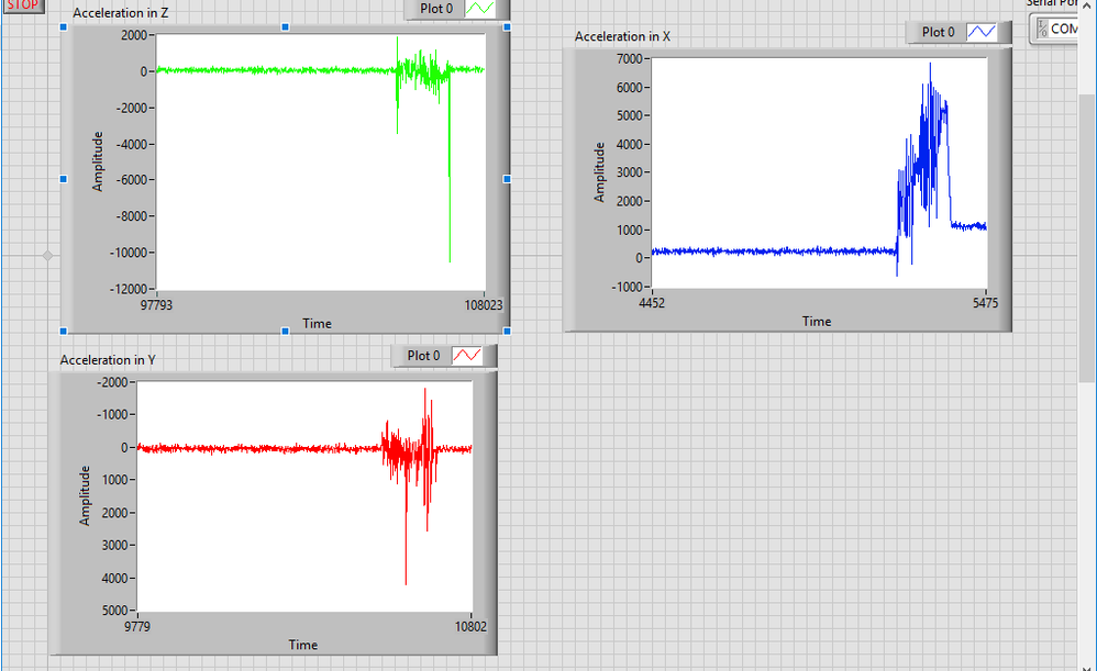

I'm new using labview, and I try to understand several post about this topic but I'm don't understand it so well. I have this three graphs that I receive from a sensor:
I would like that every graph has zero in the middle and that the new values taken by the sensor appear in the middle of the graph, since these appear generally in the end and are more difficult and late to observe. This data are dynamic, so I don't know how I can set up this parameters.
And the other hand the graph Y are in reverse order!! , how I can fixed that?

You can set the range with property nodes. If you set the ymin to -Max(abs(Y)) and the ymax to +Max(abs(Y)), the zero will be in the center. It is sufficient to set the property only when Y(max) changes. Also make sure to disable Y auto-scaling, of course.
You can use the "ptbypt min&max" matched to the chart history length. No need to constantly get the history data.
(The axis will flip depending on what edge value you enter manually, but if you set them as described, the problem will not occur.).
(If you would attach your code, we could show you in more detail)

@altenbach
I'm sorry but I'm new using Labview, and I don't understand you so well, when you say Max(abs(y)) is you way to say me that I must set up in the  property node the max value that I will measure in the Y axis?, if that so, that's a problem becouse I don't really know what it is that value :s . Or Max(abs(y)) is some type of function?? Can you tell me where is it? or how I can make the code that you try to explain me?

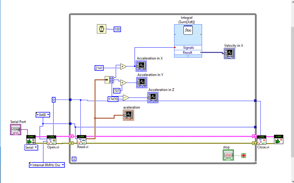

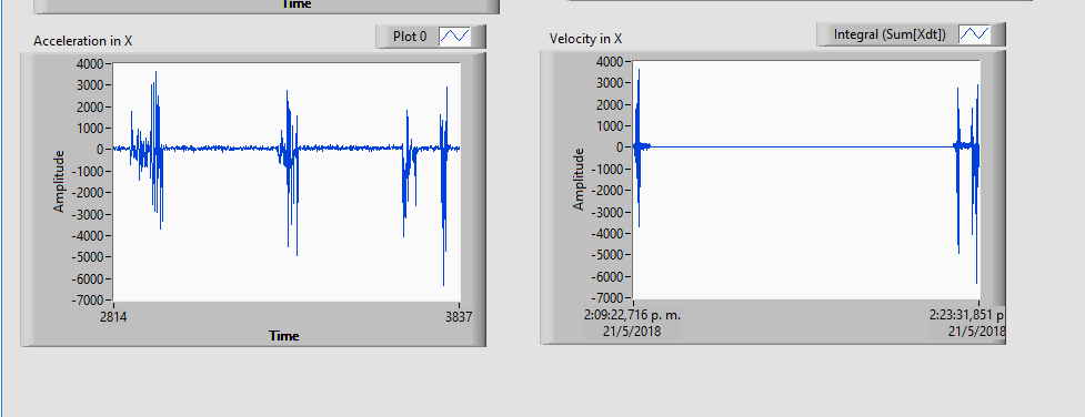

This is my code capture 19.pngIn the other hand, I try to integrate the value of the gaphs, I do it with the accelaration of X that I have and give this result:

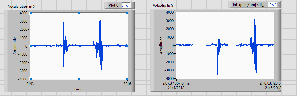

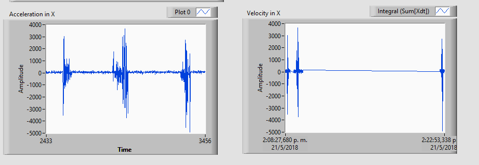

Seems well, except that  when I stop the program apeear some stranger horizontal line in the middle, when I do this graphs I stop the program two times and for that I have 2 horizontal lines that are saying above, you can see it better here:
Well I think that this graph can work if I don't stop the program. But what I really want is to scale the velocity in its real units that I want that ware mm/s, not in that units that have, How I can do that conversion?, I will like do it that with the acceleration too maybe in mm/s^2

Attach your vi.

Maybe this simple draft can give you some ideas.

I already explained how to scale your data in this thread. But I was wrong about the bitness, this module does indeed put out 16bit data as evidences by the magnitude of the raw data (>1024) and the datasheet of the device. The calculation is left as an exercise for the reader.
