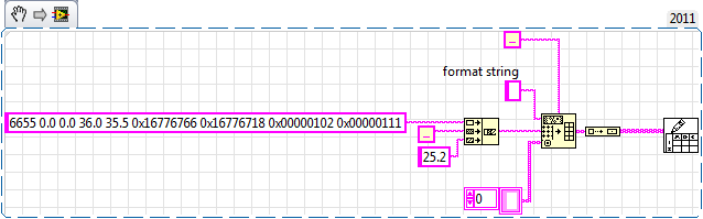

You are using "built array" instead of "concatenate string".
Since you already have an entire row to write consisting of a single string, you need to add a "build array" if you want to use "write to spreadsheet file" (see image below). You should change the format to %s. It would be easier to use plain file writes, after appending a linefeed to each row data.

Actually now I see that there is another problem that in my text file I have one line of first part string without the appended sstring from 2nd SubVI and after that in next line I have the same but this time the appended string is in next line, as below;
   6655     0.0     0.0    36.0    35.5  0x16776766  0x16776718  0x00000102  0x00000111
25.2
do u now how can I solve it  ?!

@.aCe. wrote:
As mentioned above, just use concatenate string. Hope this helps.
Your use of "spreadsheet string to array" makes no sense here, because that funtion is immediately undone inside "write to spreadsheet file" (you can open it and look at the code). What is your resoning to do it this way? Seems duplicate and convoluted!
