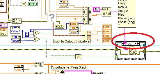

Well there's no code in the True condition, and the stacked sequence, which has the data collection code inside, is within the false condition. Unless, of course, I'm overlooking a different case structure. The original creator had a rather janky way of doing things.

@etvg wrote:
Well there's no code in the True condition ....
In the code I am looking at, the FALSE case is empty, while only the TRUE case writes to the file. If your's is different, please attach the correct code.
ItsTrue.png.
