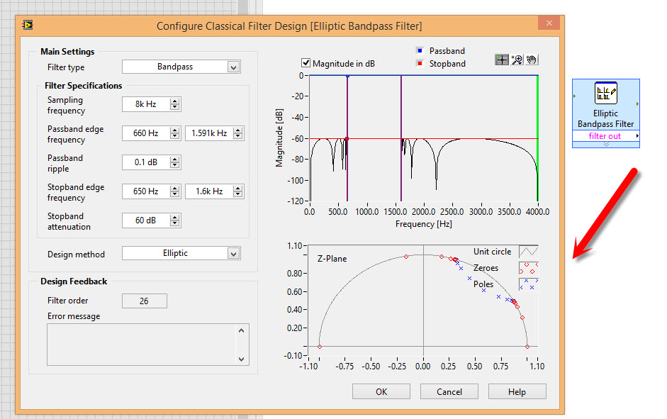

How to apply the Classical Filter Design Express VI
I use the Digital Classical Filter Design VI to design a bandpass filter (try to follow this example http://www.ni.com/white-paper/4460/en/) but then I cannot locate
Filter Express VI in order to use the filter

The filter express VI comes with LabVIEW base development system. It can be found in the functions palette under Express>>Signal Analysis>>Filter. Did you check here?
