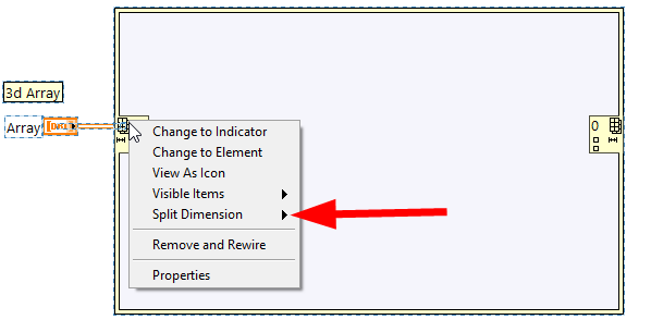

You can try the in-place structure with the Split Array Option. Change the split dimension to access what part of the array you want.

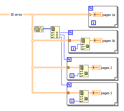

You wire the index terminal [i] of the loop to the desired index input of index array and wire N according to the size in that dimension. Depending on where you wire, you get a 2D array in one of the three possibilities.
(The first dimension of a 3D array is typically a page. Do you have some simplified example code to show us?)
Note that the top two versions are equivalent (and if you autoindex each at an output tunnel, you get a transposed (permutated?) version of the input array, depending on what index you are using).
Remember to disable autoindexing on the input tunnel.
(Note that some versions are more efficient than others because of memory order)

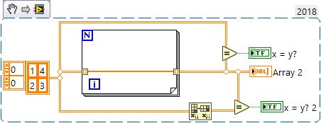

Gregory beat me to the punch. He must be faster due to all the caffeine. (He likes to brew his avatar. I always thought he was a former java programmer.)
Below is a simple example to show you.

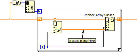

No, this is smart and as designed. To operate on arbitrary plane in-place, you would just do as follows:
A shift register is one of the most efficient ways to operate on data in place.

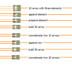

Build array has many options. If all inputs have the same number of dimensions, it can be built into an array with one more dimensions or you can switch to "concatenate" mode to append all inputs, keeping the dimension the same. Inputs to "built array" can differ by at most one dimension and if they different, the output will have the same number of dimension as the one with more dimensions and the rest will be added as elements, rows, planes, etc.). If the sizes are mismatched, the larger size wins and you get padding with default values for the datatype.
Here are some examples. Of course there are many more options and you can resize to as many inputs as you want. The only limitation is that inputs can only differ by at most 1 dimension.
