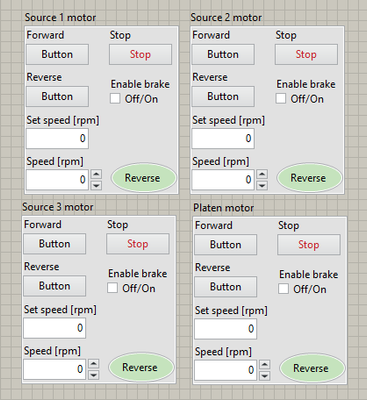

I am writing a program that uses a DQMH module to control motors, and there are 4 motors with identical controllers, each with a clone of the same module. There's a front panel in an overarching program with a cluster for each motor [see screenshot].
In the app's event loop, there's a data cluster that stores the DQMH module IDs. The only way I can really think of to handle all of these controls is to add to the event structure an individual case for each button, "Source 1 motor.Forward", "Source 1 motor.Reverse", Source 1 motor.Stop", etc x 4. That's 12 nearly identical cases being added to the event handler. Can anyone think of a cleaner way to do this? I want the clusters to all be individually visible. Otherwise, I would only have one of these control clusters and a selector for which motor.

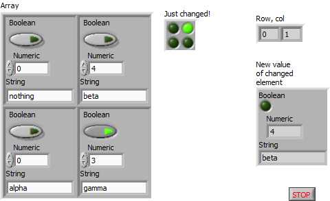

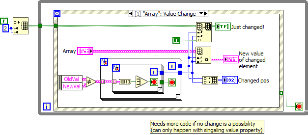

You can make the control a 2D (2x2) array of clusters, have a value change event for it, then see which one changed (by comparing new and old value from the event data node).

Here's a quick example how to use a 2D array of clusters and find which one has changed. (To be used for further decisions! You can easily reduce the 2D indices to a single index if needed)
