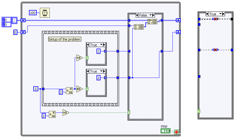

The problem statement had the different cases providing data on different iterations.
Here is the solution.  Store the previous iteration value in a shift register on the 0, 2, 4, .... iterations.  Combine the previous and the new value into the 2-D array on the 1, 3, 5, ... iterations
 Example_VI_BDExample_VI_BD

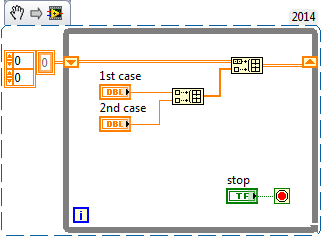

Do I understand correctly that you are alternating between different cases each iteration? Just wire the outputs in each case to the same indexing output tunnel on your while loop. If you have two unique case structures, then wire them each to their own output tunnel, with the conditional terminal enabled.  Wire a boolean through a shift register and flip its state each iteration with the Not operator, and use that line on the conditional terminals - one before the Not function and one after.  Then, you interleave the two arrays after the while loop completes.
Message 5 of 10
(5,852 Views)
Sorry - that snippet wasn't supposed to be included.  It illustrates the point though - just replace the single case structure shown with your two individual structures.
