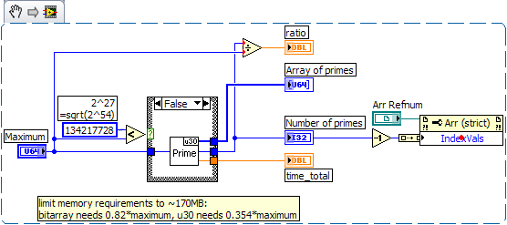

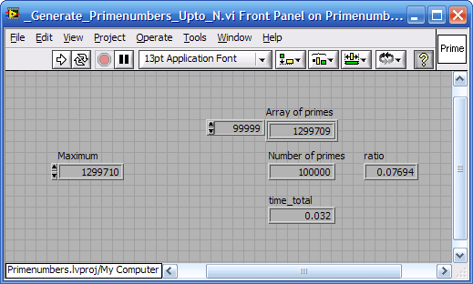

And here's you can look at my VI:
One correction to my first post: you only need to calc upto 1.3e6... The 100.000th prime is 1299709.
