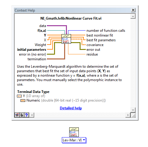

Even thought I'm still figuring out how to use the NONLINEAR VI.... For example I have the next Steinhart-Hart equation:
1/T = A+B*Ln(R) + C*Ln(R)^3
I've calculated parameters A, B, C:
A=1.126249 e-3
B=2.345631 e-4
C=0.862140 e-7
I have my X and Y and initial parameters ready. But how do I use this function... Haven't figure it out where to specify the model I'm a bit confused at the moment...

The nonlinear equation is basically a third order polynomial using the log(y) and setting the quadratic term to zero. There is no need to complicate things and use levenberg marquardt.
 There are two flavors of the nonlinear curve fit, one using VI model (preferred) and one using a formula. There are plenty of examples that ship with LabVIEW, just look at them!
