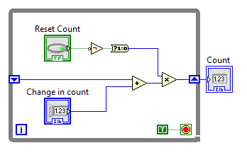

Put another way: is there a way to see how many registered event handlers a given user event has? I'm currently using this VI (see below) to keep track of the number of registered event handlers:
(call it with +1 when registering an event handler, -1 when unregistering). It feels like a hack, though, and I'm wondering if there isn't a more proper way of doing this. Ideally some kind of built-in function? This seems like something that LabVIEW would need to keep track of...

I've looked through some documentation to verify whether or not a VI like this exists and unforunately the VI library does not contain a way for the user to keep track of the number of registered events. If we had a VI in the library that had the functionality you're looking for it would probably work very similarly to yours under the hood.

Unfortunately, they are indeed asynchronously started, and a priori I don't even know how many of these event handler subVIs will be running. Some may even be started and stopped multiple times before shutdown.
Semaphores are an interesting idea; we'd have to keep one for each subVI and be a little careful about repeated starts, but it would certainly impose a stronger psychological pressure on the subVI developer: "There's a semaphore terminal in the VI type specifier; do the right thing" rather than "Please remember to call this random function before and after you register/unregister your event handler".
