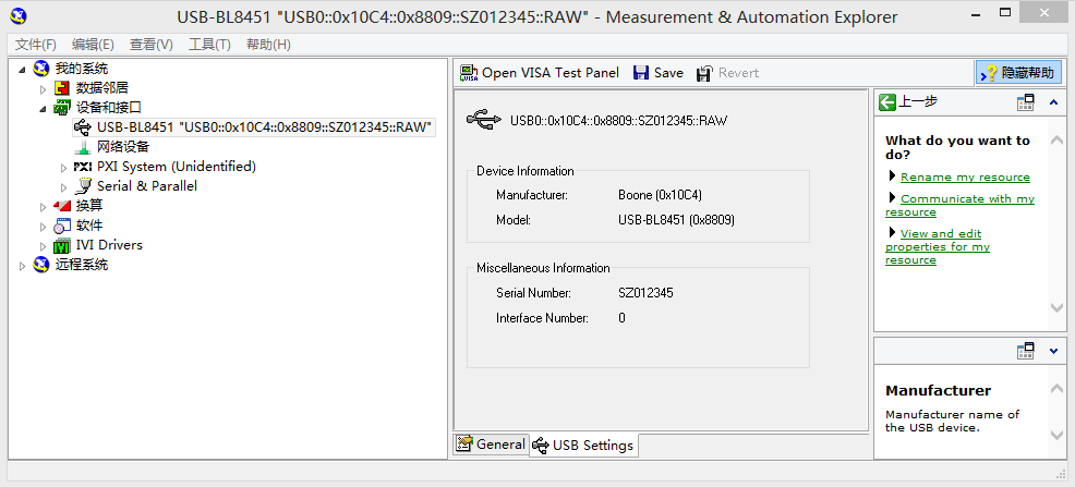

I have a chip C8051F320, I can communication with it when I use silab driver in labview.
it can find in MAX after I install NI driver by Driver Wizard, but I can't communication with this chip, what I should to do?

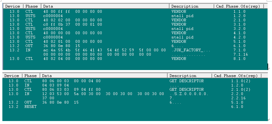

I don't get data after write data to chip, it shoud return shome data back.
I use tools to monitor USB bus as picture:

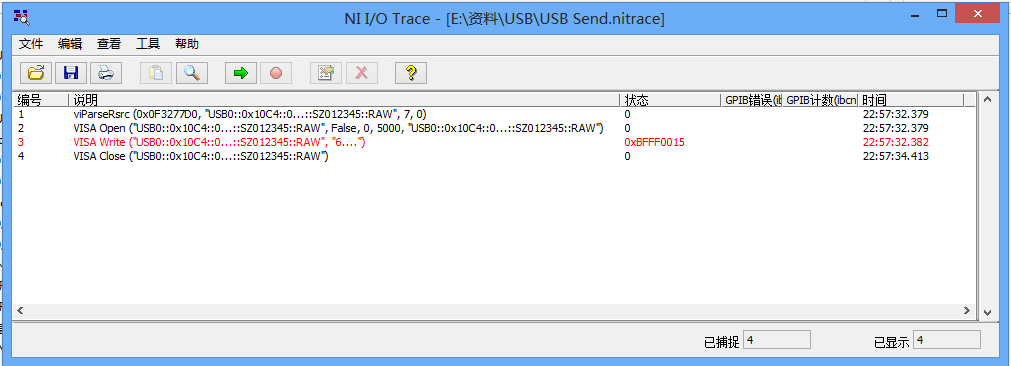

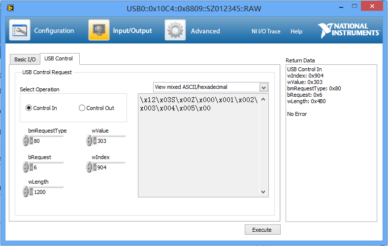

Get SN is fine, but send data is fail(my data is: 36 80 0e 80 15), who can tell me why I can't?
Message 8 of 16
(4,770 Views)
You need to get the low level RAW protocol from the vendor in order to use the VISA wizard. The write function might not even be valid. That is why using the wizard is most often just a dumb idea. Depending on what the device expects to use, the VISA wizard will not replace the original driver. This would be true for something like the Windows hid driver.
You still have not answered my question of why you have gone done this path when you said you already had it working in LabVIEW. Simply having a desire to have it listed in MAX is not a valid reason to discard something that works.
