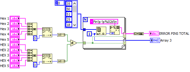

I have solved my problem. I upload the whole blovk diagram instead of someone needs it.

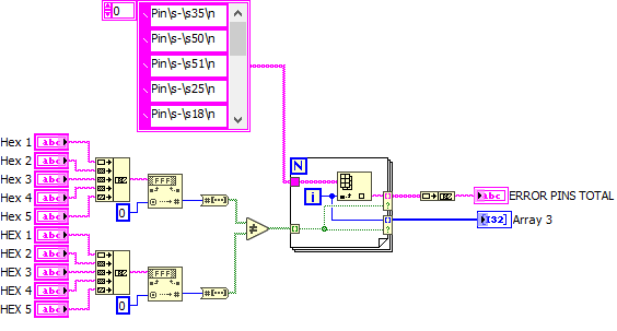

1. Why didn't you just autoindex on the array?  Then you would not need the Index Array either.
2. Instead of the case structure, make an array of strings for the possible output values.  Then you just use Index Array to get the value.
3. You should not have that many outputs on your FOR loop.  You really only need 1 autoindexing output tunnel.
4. The rest of the code looks way too complicated.  Try using a Boolean Array to make things simpler.
(4,914 Views)
Tim, I think you can combine your two FOR loops into one. (while it creates slightly more work, I don't think it'll make a noticeable difference). Is the "array 3" output even neened?
I would even go as for as creating a 1D U8 array lookup table and do the formatting of the string conditionally. Less typing of near identical strings, thus less places where typos can hide. 😄
(4,890 Views)
Nice call.  But let's go slight further: no Index Array is needed
altenbach wrote:I would even go as for as creating a 1D U8 array lookup table and do the formatting of the string conditionally. Less typing of near identical strings, thus less places where typos can hide. 😄
I was thinking that originally, but then found there there a bunch of empty strings used as if they were "do not care".
