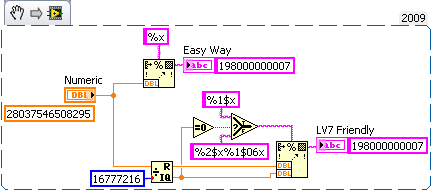

Here is a LV9 Snippet of a method that should be LV7 friendly.

Mostly a way to pull off a few tricks and avoid crossing wires.  Here is a $-free version, I changed the constant to 2^32, I had the original code for working with 48-bit numbers should have looked more closely.
